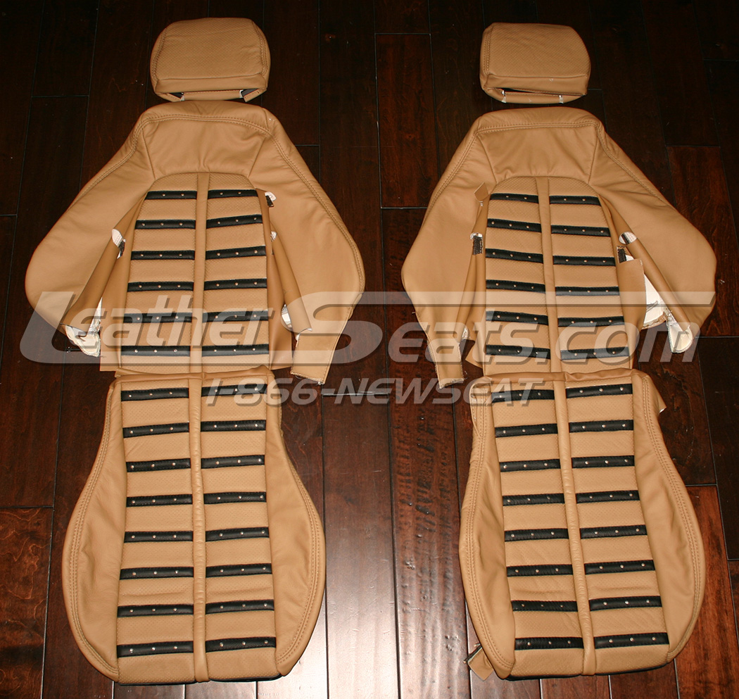

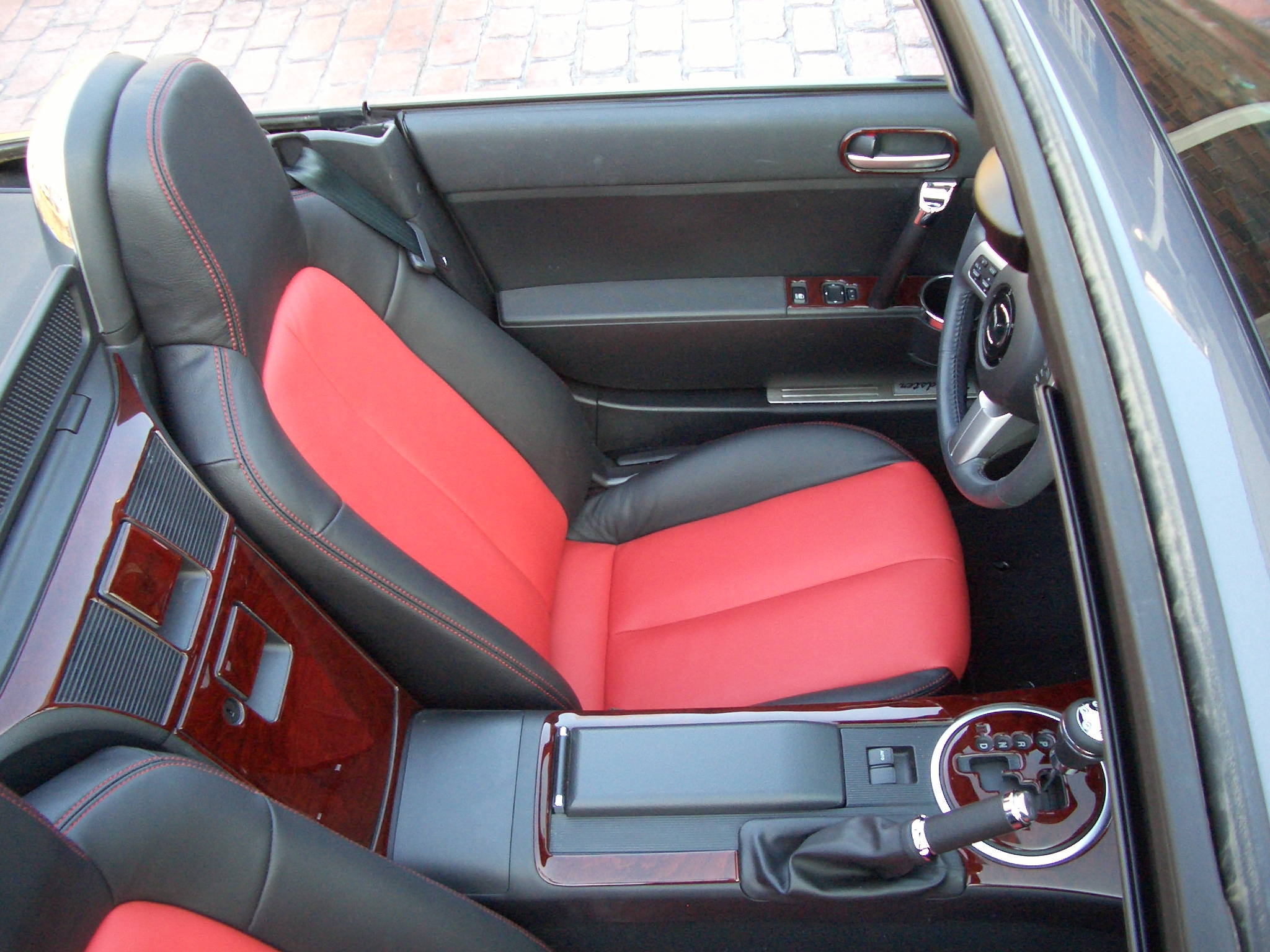

Pretty awesome. Well done. We actually use this design in some of our customer interior kits that we sell, but kind of our own version of it using leather. Here is a pic of a Miata "M" Edition interior that we did using this design cue...

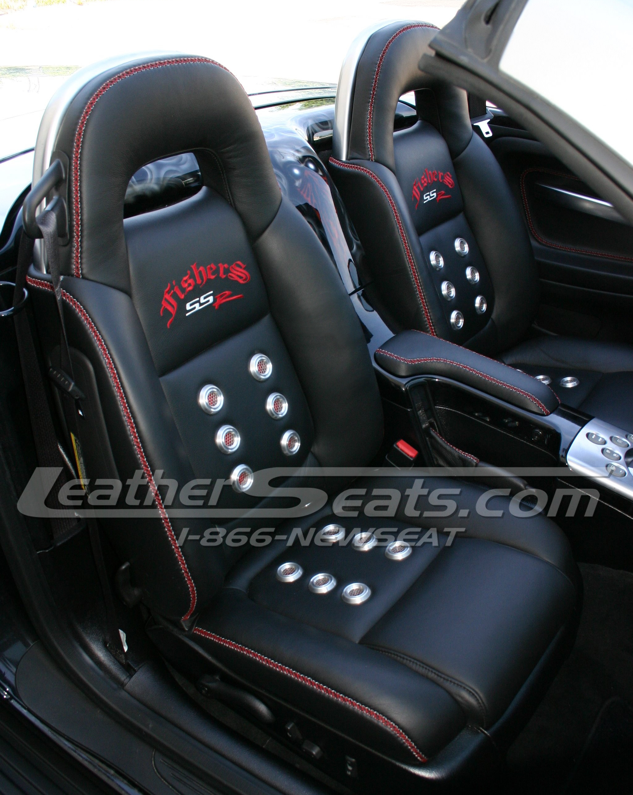

We took some design cues from the Ford GT seats as well for this Chevy SSR in the second picture...
Some of these classic designs are look pretty amazing on newer car interiors...

LS, those Miata seats look great!

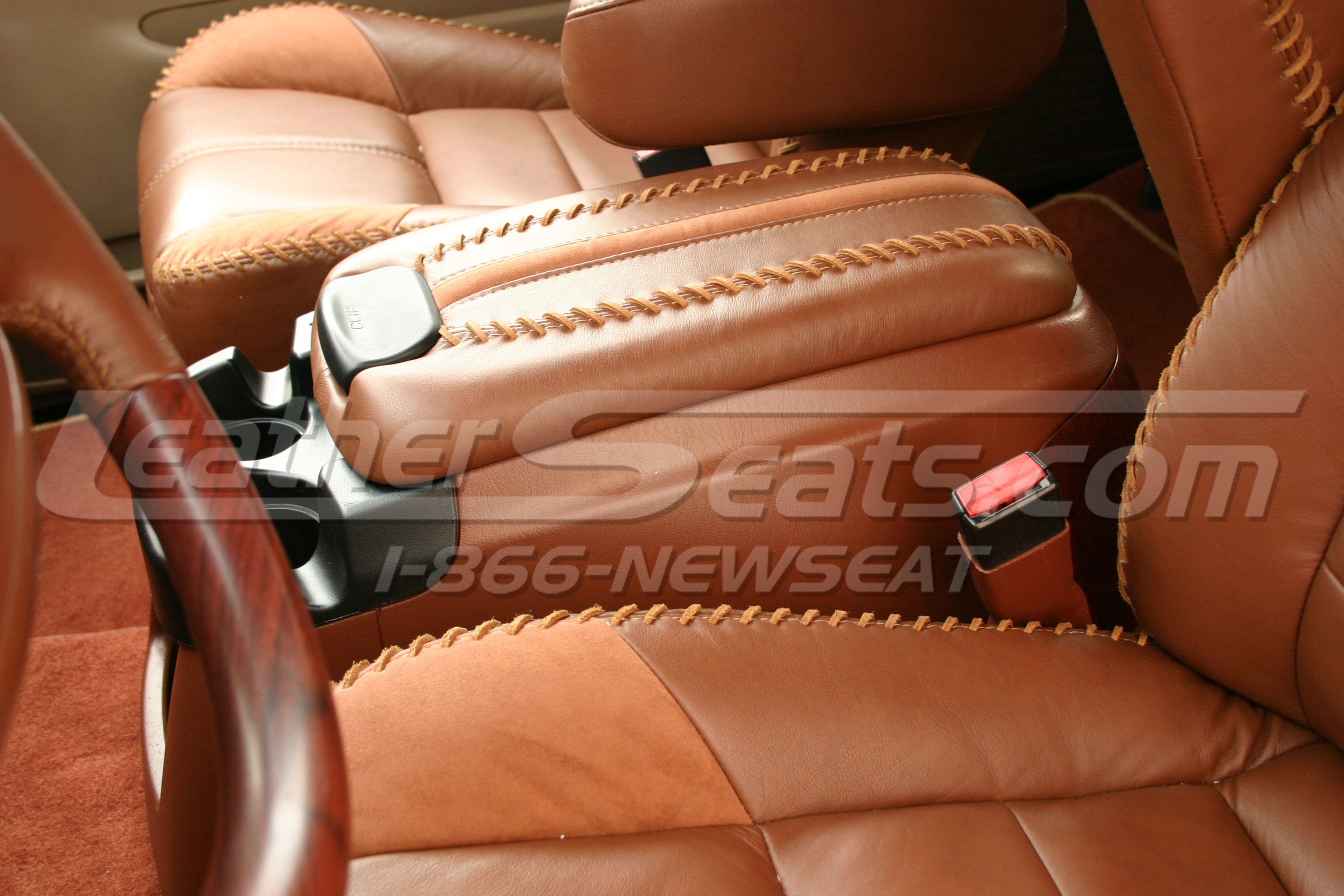

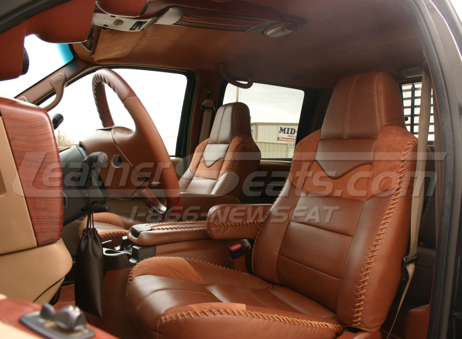

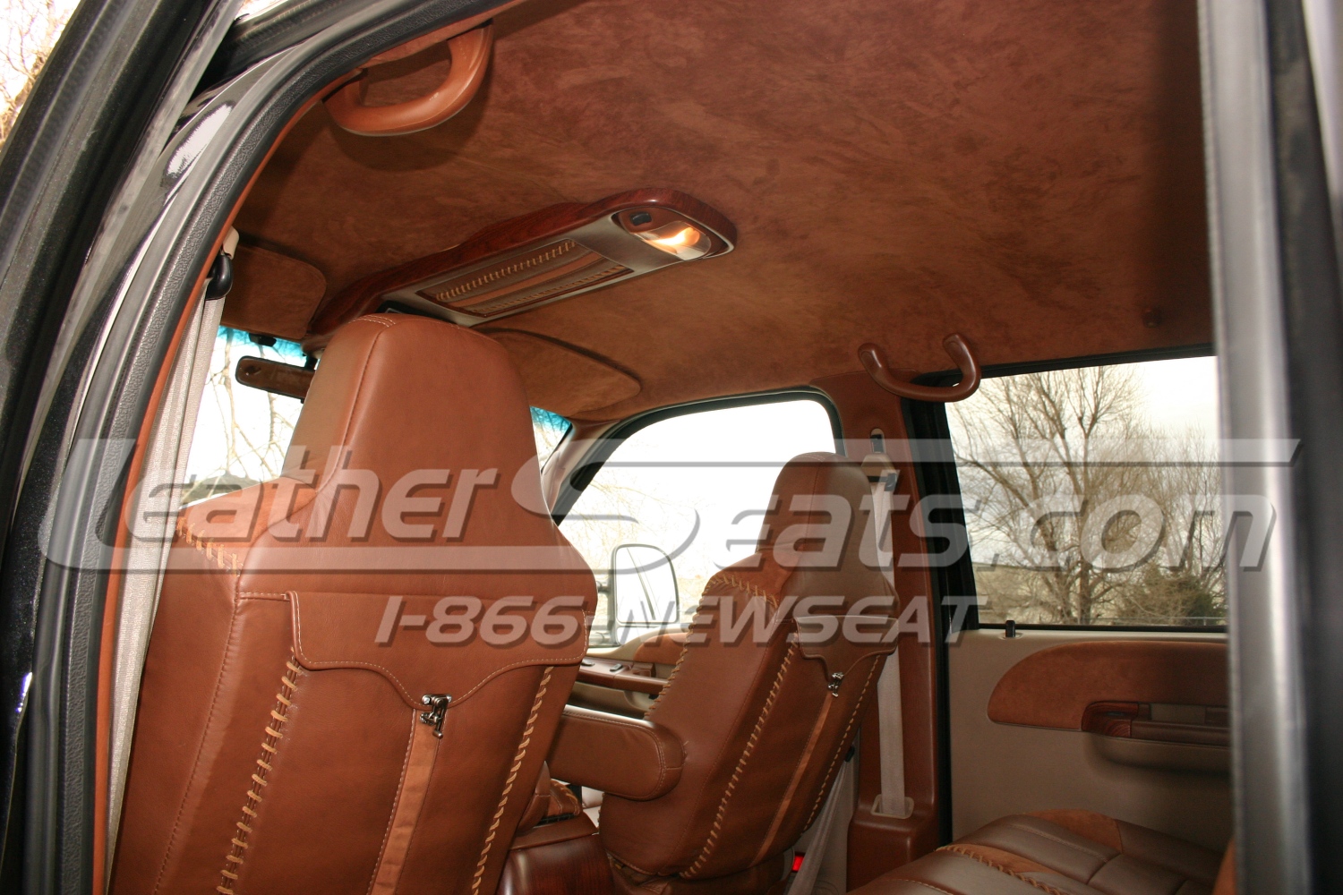

Did you lace these up before install on seat or after?

Yes they were completely laced up before installation. The lacing is mainly cosmetic as they were completely sewn and double-stitched. The holes and lacing were done after the seats were all ready, but before installation.

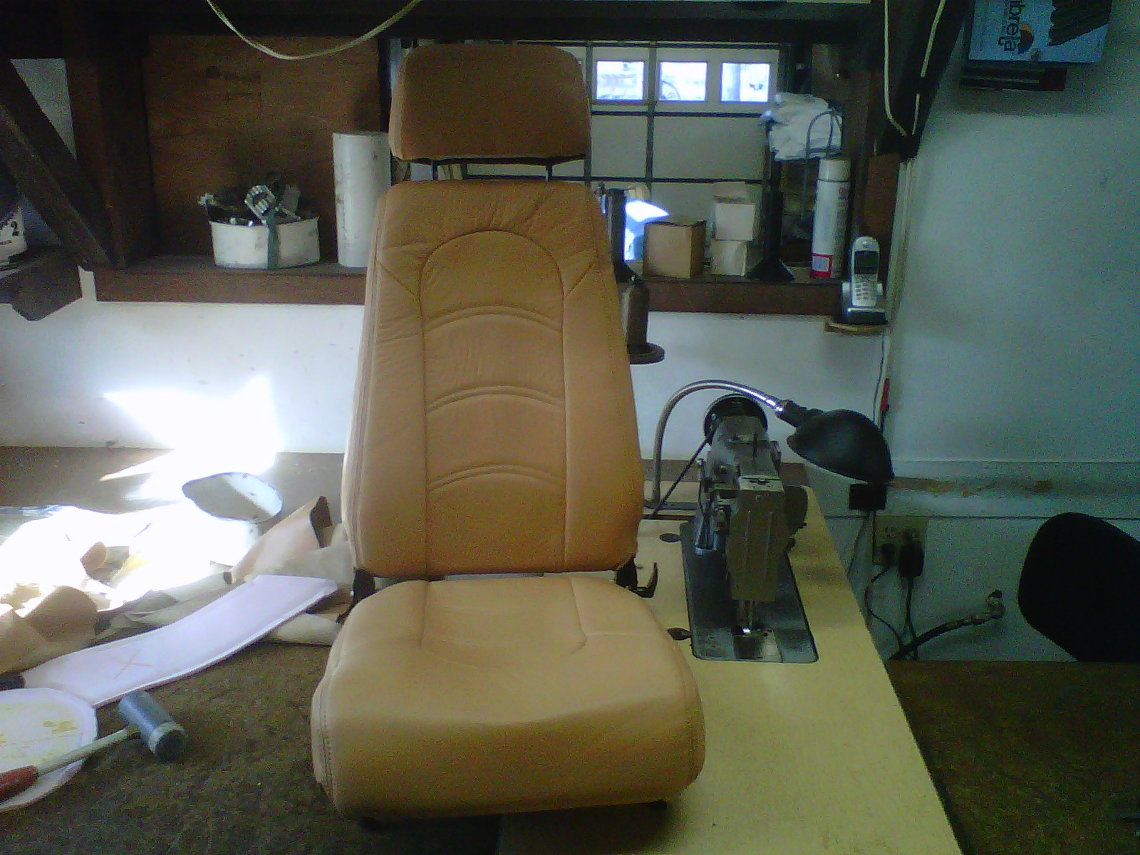

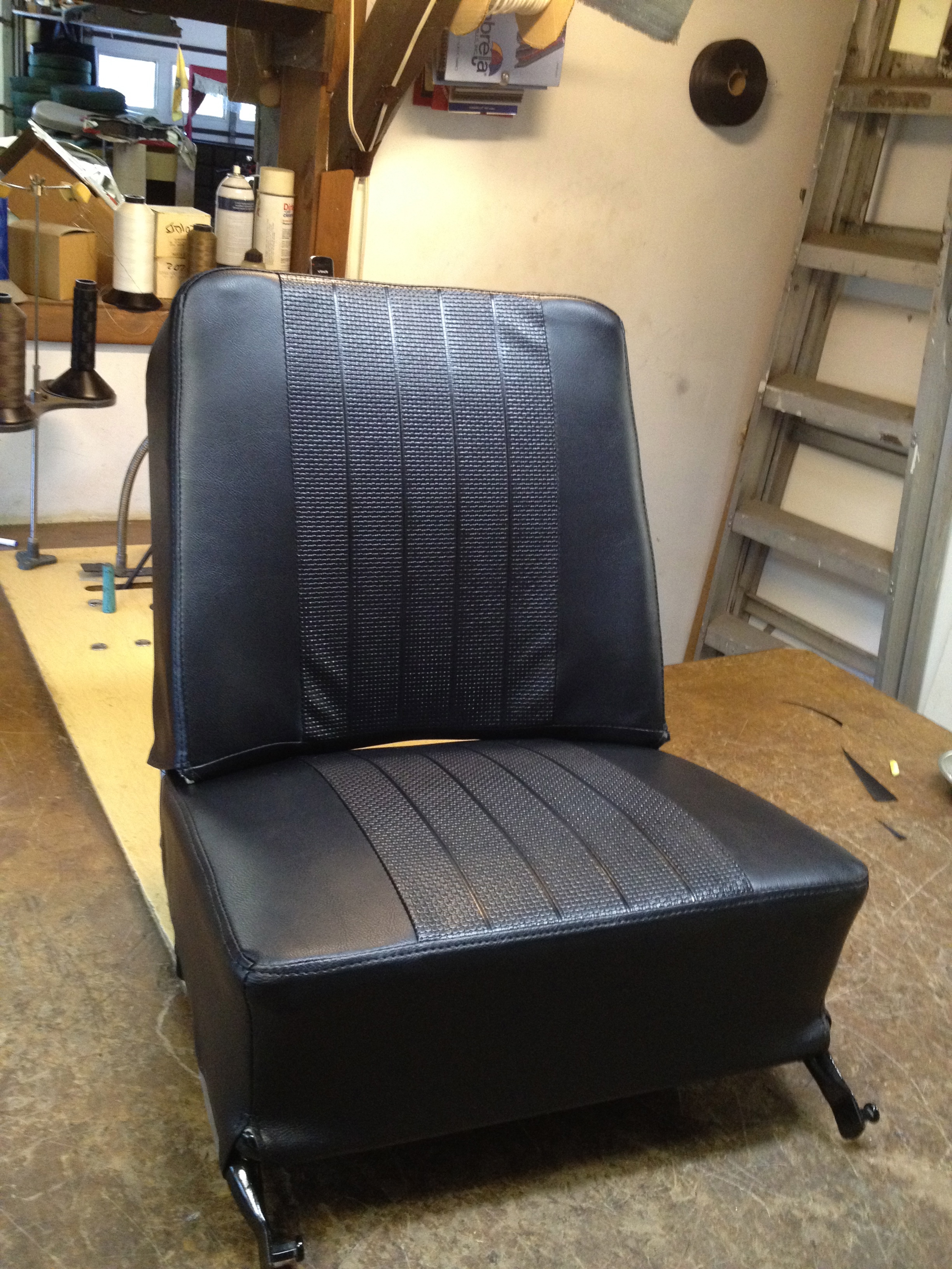

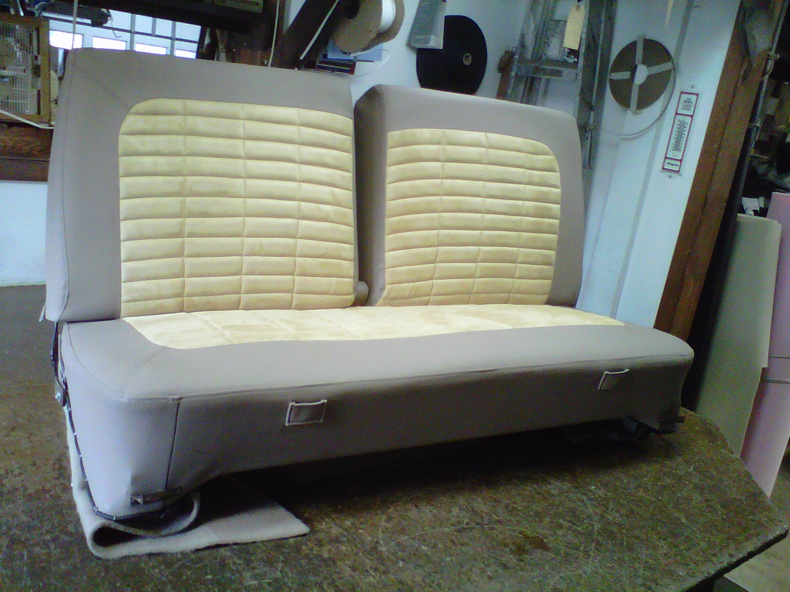

the first one is a 55 ford I did a while ago those little straps on the from are for the guys 5pt seat belt. done with allante and a velvet
the black one is for a jeep cj5 guy just wanted it plain and simple just dropped off some nicely stripped down frames.
the last one is out of an airplane. all leather. did 2 seats in it. I personally think airplanes are harder than auto, there is a lot more attention to detail and it is harder to fasten the covers.

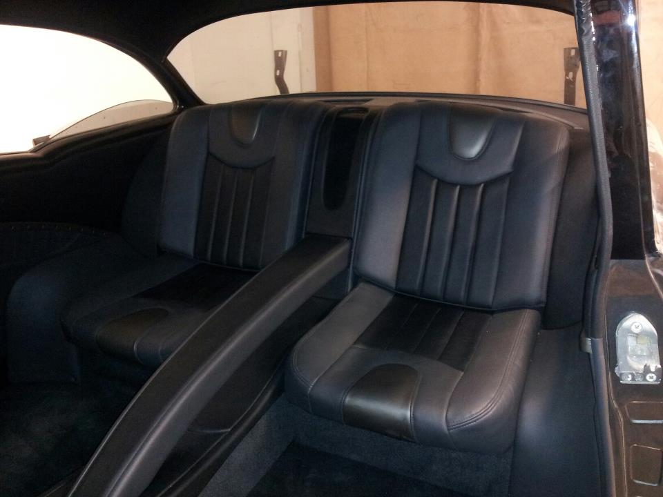

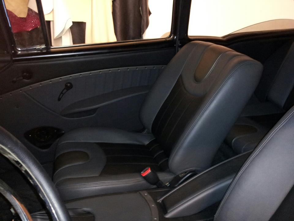

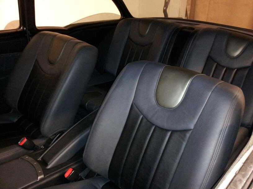

Just finished this 55 chevy up. I will post some better pictures when i get some

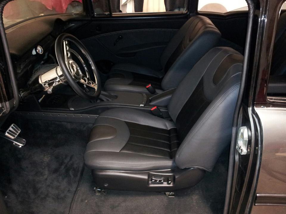

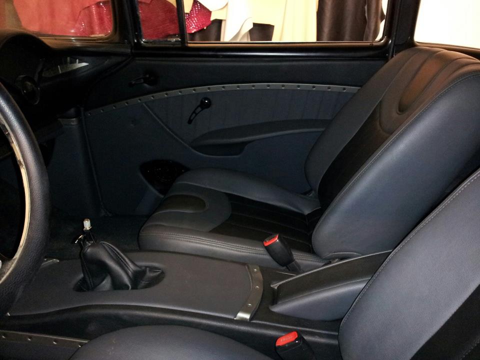

couple more shots with front seats in

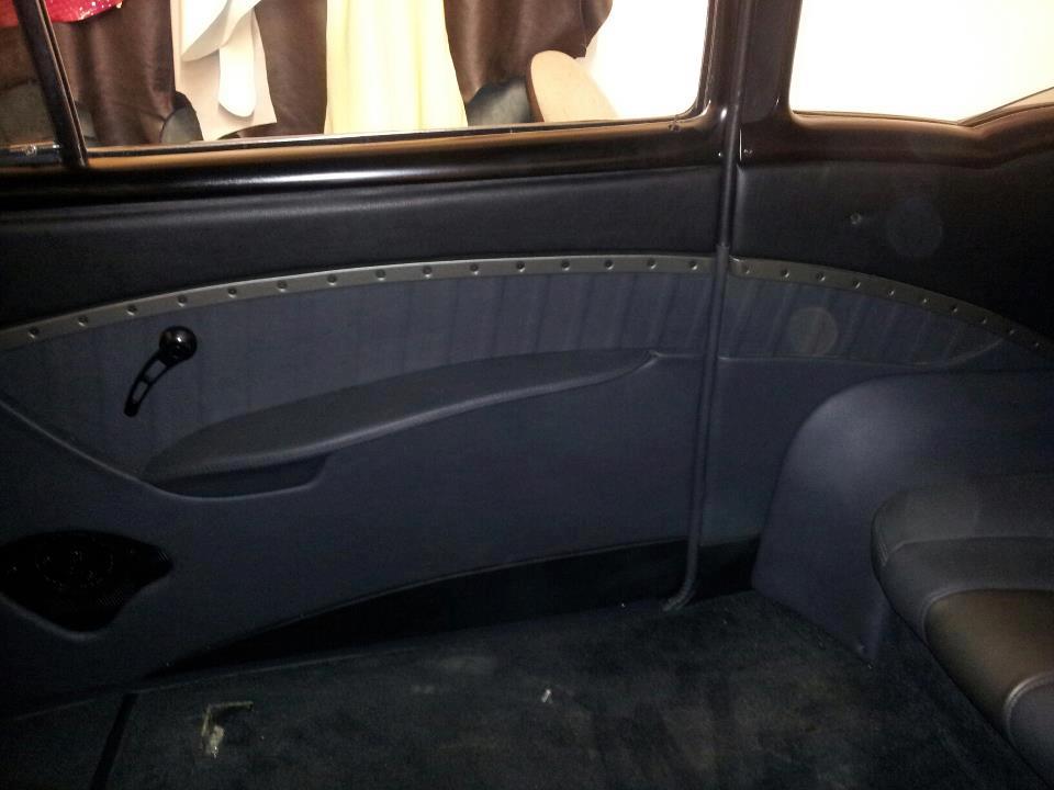

another shot

:o Awesome work! I like the design that you used and all the rear seat modifications. Looks like a great finished product as well. Awesome job!

Beautiful work Wrapped Up Interiors! I love the door panels in particular.
What color is that curved insert on the base and backrest? It looks olive green in the photos. It's a cool look!

Thanks guys. Its actually titanium color. It is a very cool material it has no grain in it and has kind of a satin finish to it. Everyone that has saw it in person ask if its metal and dont believe me when i tell them its vinyl. i have to show them a piece of it.

Great Job Wrapped up. Would it be possible to get the color number and manufact. of that vinyl, I love that. Do you have a grommet or collar of some kind inside the holes or just pulled through and stapled? What make of seats did you use?
Thanks!

I will get the material info this evening. I know that they have about 20 different colors that all look really good. The holes are actually countersunk black Allen head machine screws. The front seats are out of a infiniti. Not sure what model or year. I got them at pic a part for 25 apiece and its easy hooking up the power on them. They are out of a 4 door car so they dont have the tilt forward on them but the slide track moves the seat almost touching the steering wheel so there is plenty of room to get in. The rear seats are custom made to look like the front but the have a taper on theback with package tray its hard to see that with the pictures.

It all works very well in that car great job and planning, design. I would love to see how the allen heads are used (close up) if you have photos. Thanks for all the info.
