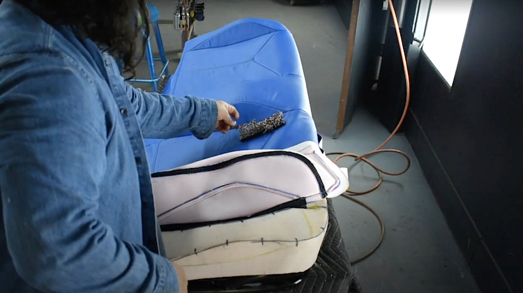

4. Sew it all together
After all the pieces are cut, Rick uses his industrial sewing machine to put the seat cover together. He takes great caution to ensure every stitch is perfect.
5. Install the custom seat cover
With the cover sewn, Rick demonstrates a few different techniques on how to attach the upholstery to the foam — including carving out channels in the foam for listing wire and velcro.
