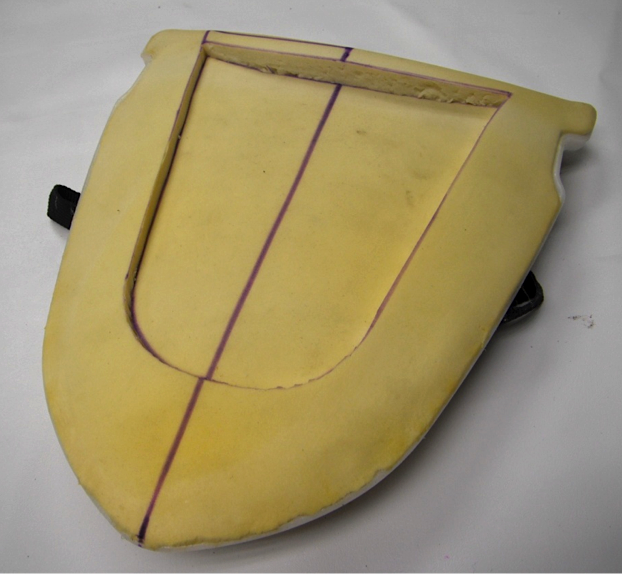

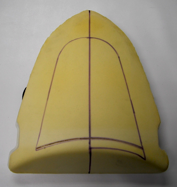

After stripping the seat’s cover, I marked the cushion’s center and outlined the section where I wanted to install the gel pad. Install the gel pad where the customer feels the most discomfort.

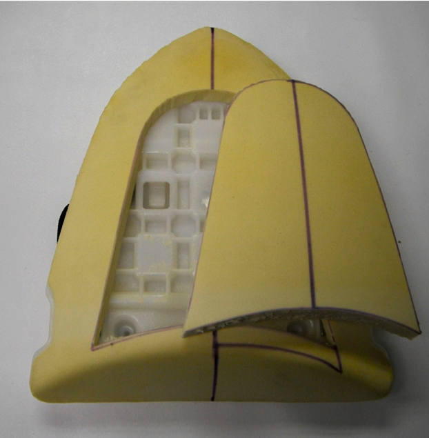

Using a sharp razor blade, I cut out the section where the gel pad would be placed.

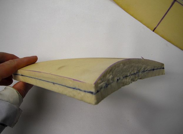

I drew a line on all sides of the cut section measuring ½” from the bottom. Discarding the bottom section and using the top enables me to keep the factory curve of the seat.

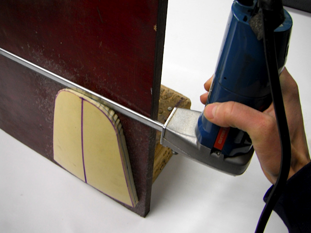

To keep the foam steady while cutting it, I glued it to a piece of wood.

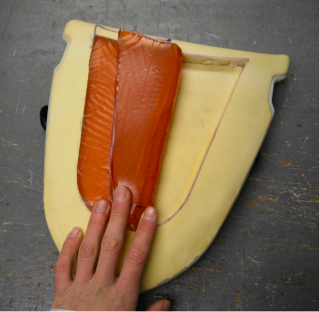

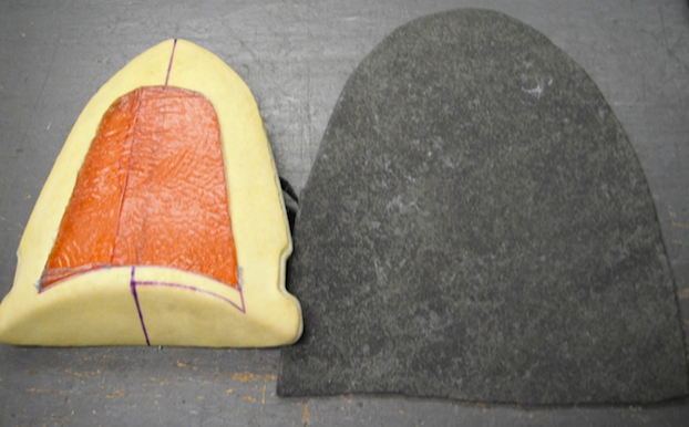

I glued the top half of the foam back inside the seat, but only after tracing it on a gel pad. This guarantees that the gel pad – once cut – will be the appropriate size.
I cut the gel pad and glued it on top of the foam I just re-installed.
I cut a piece of headliner material large enough to cover the entire motorcycle seat.
I glued the headliner material over the entire seat. This ensures a uniform look that is free of bumps or creases once the seat cover is installed.

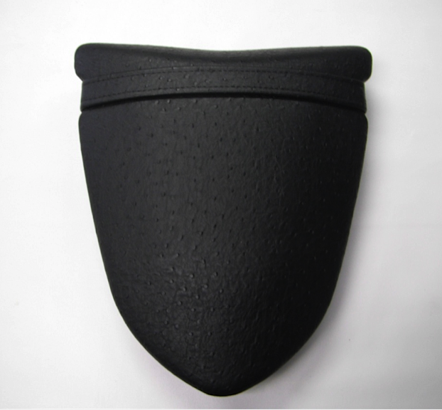

I then trimmed the motorcycle seat in ostrich-grain vinyl.
And there you have it, a more comfortable motorcycle seat!
