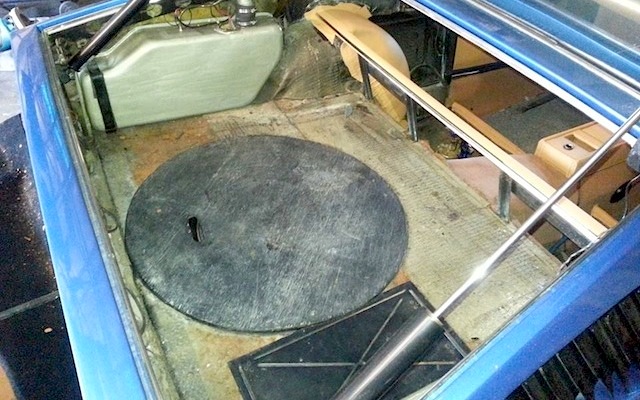

Brent took no shortcuts in trimming any aspect of the Espada’s interior — so he certainly wasn’t going to start with the carpet. He did some serious preparation work to ensure it met his customer’s high standards.
“The owner wanted Dynamat installed, so the whole floor had to be stripped down to bare metal washed and cleaned,” he explained. “I then heat-proofed the floor.”
After installing Dynamat, Brent added a second layer of insulation by covering the floor with carpet jute padding.
Brent turned to Wilton Wool III carpet to find the perfect shade of carpet to match the beige Napa leather he used throughout the rest of the cabin. “I find it a really nice carpet to work with and I used about nine or so yards including the trunk,” he explained.
Of course, the carpet had to be crafted from scratch. “I cut and made all my own carpet patterns then bound it with leather,” Brent said. He also glued a thin layer of felt to the back of the carpet “to give it more body.”

Of course, the cargo hull had to be carpeted as well.
