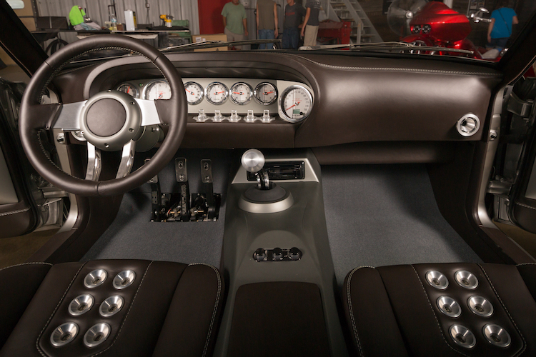

Building the Dashboard
Customs by Vos had to create a GT40-inspired dashboard from scratch, as the vehicle’s interior was gutted.
“When we first got the car, there was nothing in it,” said Dave. “The only thing we had to work with was a steering column that didn’t fit and a set of authentic GT40 gauges.”
The team began by creating a mold for the dashboard.
“Out of aluminum, paper, cardboard and tape we created the first step in a mold to resemble a GT40 dash,” said Dave. “Once we had a good shape for our mold, we fiberglassed it, which gave us a great structure to start with. From there we added aluminum braces and mounts to the structure, so that we could install it in the car.”
“When the dash was mounted in the car we were then able to configure and wire up the gauges and switches. We also had to mount the A/C system and run the lines to the vents that we installed in the dash. Once we had every dash component mounted in place, we lightly body-worked the surface and painted it in primer.”
After constructing the dashboard, the team removed it from the vehicle and stripped off all the components. They then made a pattern, which was cut from leather, stitched together and glued onto the fiberglass.
They then remounted all the components and reinstalled the dashboard in the cabin.
Creating the Center Console
Replicating the center console of the Ford GT40 was crucial in pulling off the inspired look of the Mustang’s interior.
“We started the console by pulling a fiberglass mold from the transmission tunnel and part of the floorboard,” said Dave. “Once we had a mold, we were able to create a base for the console to sit on. That base was then wrapped in leather.”
After the base was constructed and trimmed, the team began constructing the console.
“We poured a two-part expanding foam to give us a raw structure to carve the shape of our console,” said Dave. “When we achieved the desired shape, we then mounted the A/C controls, radio, and built a storage area with a thin armrest pad. After all of the console components were mounted, we lightly body-worked it and sent it to paint.”
Dave is particularly proud of the shifter. “We modified one of the seat buttons to fit inside the shifter to help the design flow,” he said.

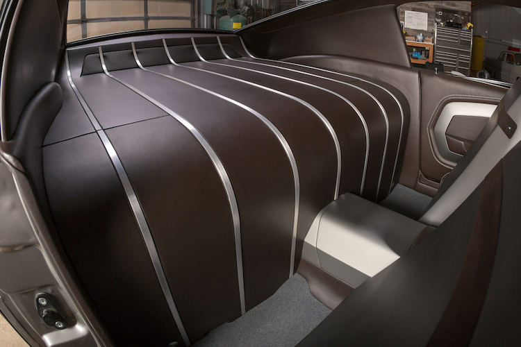

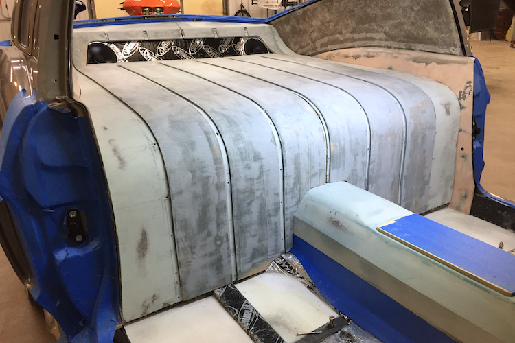

Deleting the Rear Seat
Oversized wheel wells were required to accommodate the massive rear wheels and tires of the Mustang, which left no space for a backseat. This presented no problem, as the GT40 was a two-seater.
Nevertheless, something needed to be done to tidy up the rear half of the cabin. So the team went to work on covering the wells.
Using aluminum, composites and fiberglass they built a cascading structure with hidden storage compartments behind the front seats. The structure was built in two pieces so that it could be removed from the vehicle and upholstered in leather.
Seven hand-formed 1/2″ wide aluminum strips were inlayed into the fiberglass, adding a touch of class and just enough contrast to breakup the sea of brown leather in the rear half of the cabin.
Matching sail panels connected the rear seat-delete to the custom headliner.
